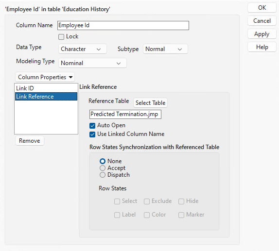

• You can also increase portability by using a JMP path variable in the Link Reference path. Figure 5.10 shows an example. Enter a forward slash in the path to share the data tables with both Windows and Apple macOS users. For more information about path variables, see “Path Variables” in the Scripting Guide.

Figure 5.10 Link Reference Column Property Definition
