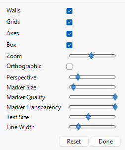

Scatterplot 3D Settings
To customize properties such as the marker size, text size, and grid lines, right-click the 3D scatterplot and select Settings. The Settings window appears. As you modify the settings, a preview appears on the 3D scatterplot.
Figure 9.7 The Scatterplot 3D Settings Window
Note the following tips:
• Move the sliders to the left to decrease the selected property or to the right to increase the selected property.
• Click and drag the top portion of the window to move the Settings window around the scatterplot.
The following options are available:
Reset
Resets the default settings.
Done
Closes the window.
Walls
Adds or removes the 3D scatterplot walls. Without walls, the background color of the 3D scatterplot is displayed.
Grids
Shows or hides the coordinate lines.
Axes
Shows or hides the variable names that appear above each axis.
Box
Shows or hides the box. Without the box, the 3D scatterplot is displayed as an open plot.
Zoom
Enlarges or shrinks the 3D scatterplot.
Orthographic
Changes the view of the scatterplot from three-dimensional to an orthographic projection. In the orthographic view, the walls of the scatterplot do not converge to a vanishing point. This means that you can compare near and far distances and see the structure between data points.
Note: If you turn off orthographic view and completely decrease the perspective, the walls of the scatterplot do not converge. This is the same effect that you get when you turn on orthographic view.
Perspective
Increases or decreases the perspective. Large values create a view that is unnaturally large and visually disorienting. In this case, you need to resize the scatterplot window to show the entire plot.
Marker Size
Increases or decreases the size of the data point markers.
Marker Quality
Increases and decreases the data marker quality. For example, when you increase the marker quality, some markers have an opaque center. Other symbol markers are formatted in bold. Increase the zoom to see these changes in quality.
Marker Transparency
Increases or decreases the transparency of the data markers.
Text Size
Increases or decreases the text size.
Line Width
Changes the width of the coordinate and axes lines.
