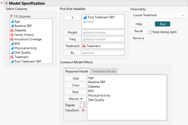

1. Select Help > Sample Data Folder and open Blood Pressure Treatment.jmp.
3. Select Post Treatment SBP from the Select Columns list and click Y.
4. From the Personality list, select Causal Treatment.
5. Select Treatment from the Select Columns list and click Treatment.
6. Select Age, Baseline SBP, Diabetes, BMI, Physical Activity, and Diet Quality and click Add on the Response Model tab.
Figure 14.2 Completed Fit Model Launch Window That Shows Response Model Tab

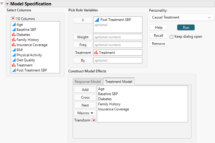

7. Select the Treatment Model tab.
8. Select Age through Insurance Coverage and click Add.
Figure 14.3 Completed Fit Model Launch Window That Shows Treatment Model Tab

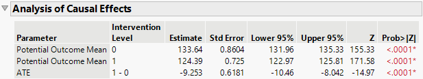

The Model 1 report contains the Analysis of Causal Effects table that shows two Potential Outcome Mean estimates and an ATE estimate. The Potential Outcome Mean estimate at Intervention Level 0 shows the expected value of SBP had no observation in the sample received treatment. The Potential Outcome Mean estimate at Intervention Level 1 shows the expected value of SBP had every observation received treatment. The ATE is the difference between these two values. The ATE estimate is -9.25 with a 95% confidence interval of -10.46 to -8.042. Under the proper causal assumptions, you conclude that, on average, the new medication lowers SBP by 9.25 millimeters of mercury compared to the control.

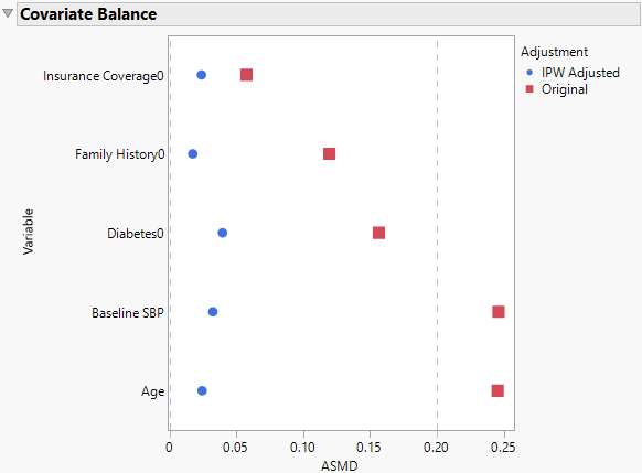

The Covariate Balance plot in Figure 14.5 shows the absolute standardized mean difference (ASMD) between the control and treatment groups for each variable that is specified in the treatment model. The red Original points show that the control and treatment groups have different profiles with regard to these covariates. The blue points show how these differences are reduced by inverse probability weight (IPW) adjustment. After IPW, the treatment and control groups should be similar across all levels of the covariates (except the treatment), as if treatment had been assigned randomly.
Figure 14.5 Covariate Balance Plot in the Model Report
