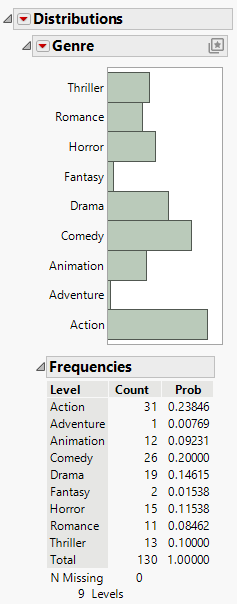

2. Select Analyze > Distribution.
3. Select Genre and click Y, Columns.
4. Click OK.
Figure 5.13 Distribution of Genre
Note that Genre has nine levels, so it is represented by eight model terms. Further data exploration reveals that, because of missing data, only eight levels are considered by Stepwise.

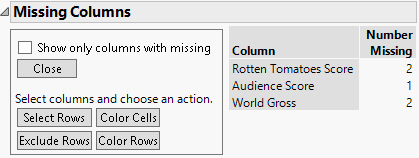

5. In the data table’s Columns panel, select the columns of interest: Rotten Tomatoes Score, Audience Score, and World Gross.
6. Select Analyze > Screening > Explore Missing Values.
7. Click Y, Columns and then click OK.
Figure 5.14 Missing Columns Report
Note that Rotten Tomatoes Score is missing in two rows, Audience Score is missing in one row, and World Gross is missing in two rows.
8. In the Missing Columns report, select the three columns that are listed under Column.
9. Click Select Rows.
In the data table’s Rows panel, you can see that three rows are selected. Because these three rows contain missing data on the predictors or response, they are automatically excluded from the Stepwise analysis. Note that row 128 is the only entry in the Adventure category, which means that category is entirely removed from the analysis. For the purposes of the Stepwise analysis, it follows that Genre has only eight categories. Now that you have seen the effect of the missing data, you conduct the Stepwise analysis.

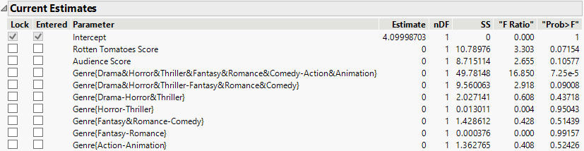

14. Select Stepwise from the Personality list.
15. Click Run.
Figure 5.15 Current Estimates Table that Shows List of Model Terms
In the Current Estimates table, note that Genre is represented by 7 terms. You construct a model with two of these terms to see how the terms are defined.
16. Check the boxes under Entered next to the first two terms for Genre.
– Genre{Drama&Horror&Thriller&Fantasy&Romance&Comedy-Action&Animation}
– Genre{Drama&Horror&Thriller-Fantasy&Romance&Comedy}
17. Click Make Model.
