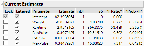

7. Click Enter All.
Figure 5.28 All Effects Entered into the ModelĀ

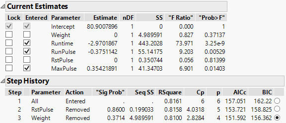

8. For Direction, select Backward.
9. Click Step two times.
The first backward step removes RstPulse, and the second backward step removes Weight.
Figure 5.29 Current Estimates with Terms Removed and Step History TableĀ
The Current Estimates and Step History tables summarize the backward stepwise selection process. Note the BIC value of 156.362 for the third step in the Step History table. If you click Step again to remove another parameter from the model, the BIC value increases to 159.984. For this reason, you choose the step 3 model. This is also the model that is fit when you use the Go button to automatically run the backward selection.
