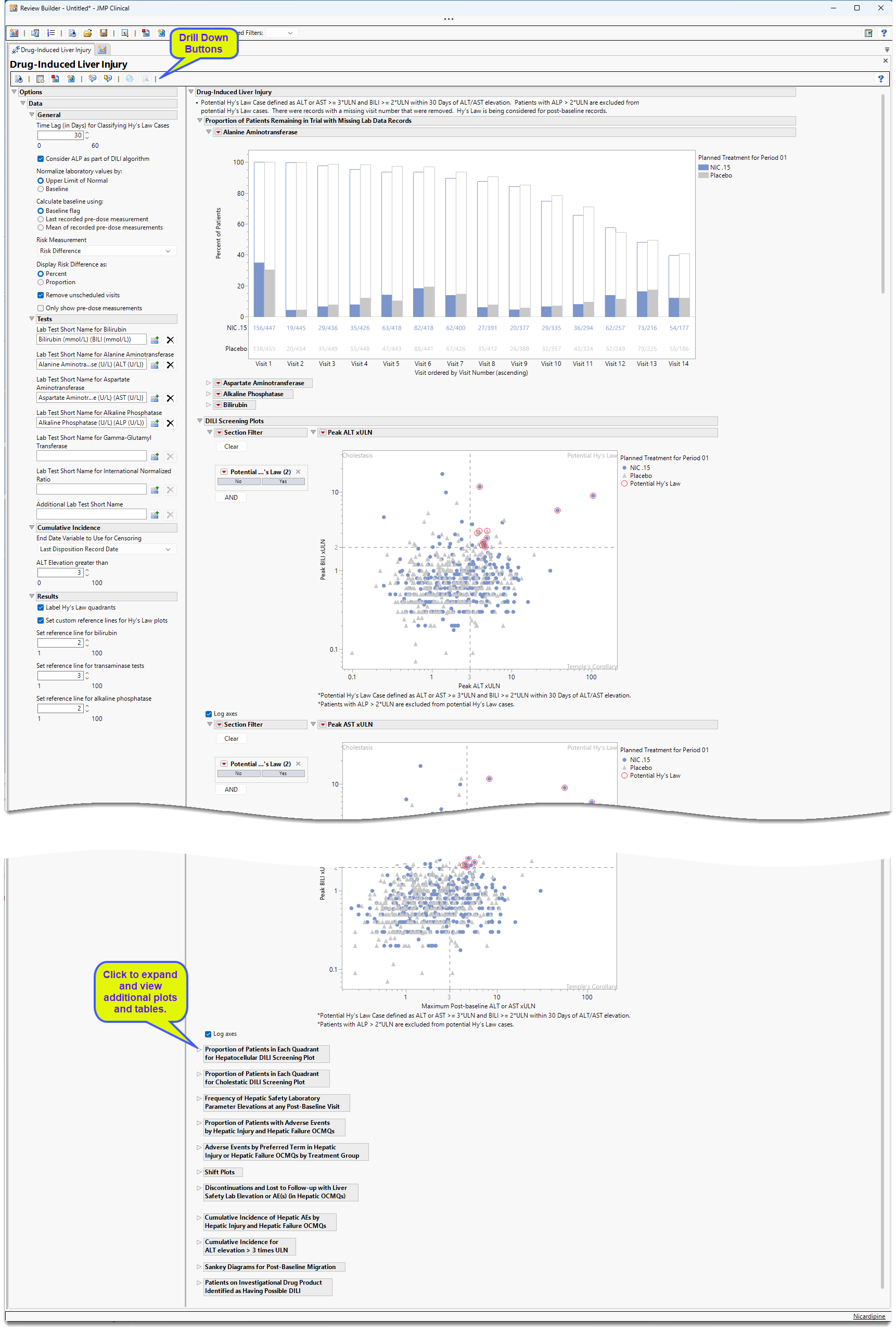

Running this report with the Nicardipine sample setting generates the report shown below.
The Report contains the following elements:
Proportion of Patients Remaining in Trial with Missing Lab Data Records
Contains 4 stacked Bar Charts (depending on the tests specified) showing the percent of subjects at each visit who either had relevant labs (filled bars) or were missing those tests (unfilled bars).
A separate plot is displayed for each specified test (ALT, ALP, AST, and BILI). Subjects are colored by treatment group.
The percentage of subjects with test data at each visit is shown by the filled bars. The relative number for this group is shown below the plot. There is a separate bar for each treatment arm. The percentage of subjects missing the test data is shown by the empty bar stack atop the filled bar. The total height of the stacked bar pair indicates the percentage of subjects for each arm present at the visit.
DILI Screening Plots
Displays an overall scatter plot of peak ALT, AST, BILI, and ALP measurements across the study, with color used to indicate treatment arm.
The Peak Liver Test Results section consists of the following elements:
• One Overlay Plot of Hy's Law Lab Tests.
This plot shows maximum laboratory values for the Alanine Aminotransferase (ALT, shown above), laboratory test, Aspartate Aminotransferase (AST) and Alkaline Phosphatase (ALP) laboratory tests (x-axis). The maximum laboratory values for the test for Total Bilirubin (BILI) is always shown on the y-axis. The values are log10 and normalized by the Upper Limit of Normal (LBSTNRHI) (with the option to normalize by baseline values). Subjects are colored and marked by treatment arm. Reference lines are drawn by default at 3*ULN for ALT and AST and 2*ULN for BILI and ALP. These reference limits can be customized on the dialog. Additional information is listed below the plot.
These limits are also used to create the Hy's Law indicator flag. Subjects with a test value exceeding 3*ULN for ALT or AST (signs of hepatocellular injury) accompanied or followed by elevation of 2*ULN or greater for the BILI test have a "Yes" value for the Hy's Law Case variable created. You can change the number of days following ALT/AST elevation for which to look for BILI elevation to flag possible Hy's Law cases on the report dialog. You can choose to label the quadrants of Hy's Law (Cholestasis, Hy's Law, and Temple's Corollary) in the scatterplot through a check box option on the dialog.
8 Click the check box to toggle between linear and log scales on the axes.

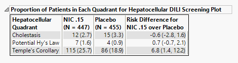

Proportion of Patients in Each Quadrant for Hepatocellular DILI Screening Plot
The table shown in this section summarizes the results shown in the Peak Liver Test Results plot.
The number of patients as well as the percentage of patients (in parentheses) for each liver disease are displayed. Risk differences are calculated by subtracting the proportion of patients exhibiting changes, in maximum liver enzyme measurement values, indicative of damage in the control group from the proportion of patients exhibiting corresponding values in the treatment arm.

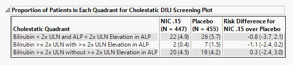

Proportion of Patients in Each Quadrant for Cholestatic DILI Screening Plot
The table shown in this section summarizes the patients showing evidence (high bilirubin and/or alkaline phosphatase) of cholestatic liver injury from the Peak Liver Test Results plot above.
The number of patients as well as the percentage of patients (in parentheses) for Cholestatic disease are displayed. Risk differences are calculated by subtracting the proportion of patients exhibiting changes, in maximum bilirubin and/or ALP measurement values, indicative of damage in the control group from the proportion of patients exhibiting corresponding values in the treatment arm.

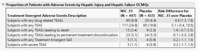

Proportion of Patients with Adverse Events by Hepatic Injury and Hepatic Failure OCMQs
The table shown in this section summarizes adverse events suffered by patients in both treatment arms.
The number of patients as well as the percentage of patients (in parentheses) exhibiting adverse events are displayed. Risk differences are calculated by subtracting the proportion of patients exhibiting these events in the control group from the proportion of patients exhibiting corresponding values in the treatment arm.

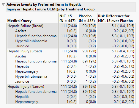

Adverse Events by Preferred Term in Hepatic Injury or Hepatic Failure OCMQs by Treatment Group
The table in this section summarizes patient adverse events by FDA medical query and preferred term for patients in each treatment arm.
The number of patients as well as the proportion of patients (in parentheses) exhibiting adverse events in the hepatic injury and hepatic failure FDA medical queries. Risk differences are calculated by subtracting the proportion of patients in the control group from the proportion of patients exhibiting corresponding values in the treatment arm.

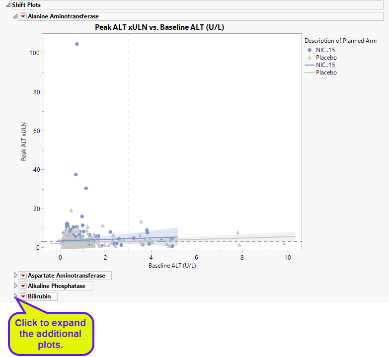

Shift Plots
These plots show how findings levels change from baseline values as a result of treatment.
Blue points represent patients treated with nicardipine. Gray points represent patients receiving the placebo. The approximately square spread of points (with a diagonal line splitting approximately even across it) indicates similar variability of measurements before and after treatment.

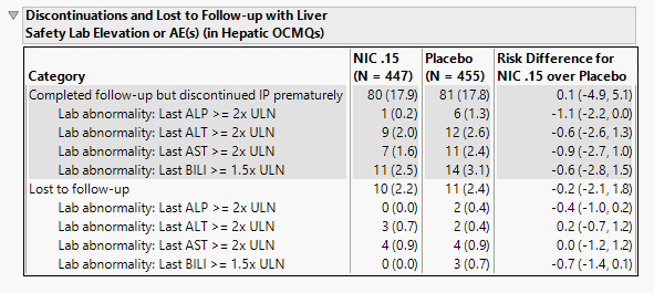

Discontinuations and Lost to Follow-up with Liver Safety Lab Elevation or AE(s) (in Hepatic OCMQs)
The table in this section shows the proportion of patients with liver damage who either discontinued or left the trial.
The number of patients as well as the proportion of patients (in parentheses) exhibiting abnormal liver tests and/or hepatic adverse events and either discontinued or were otherwise lost to follow-up assessments are displayed. Risk differences are calculated by subtracting the proportion of discontinued or lost patients in the control group from the proportion of patients exhibiting corresponding values in the treatment arm.

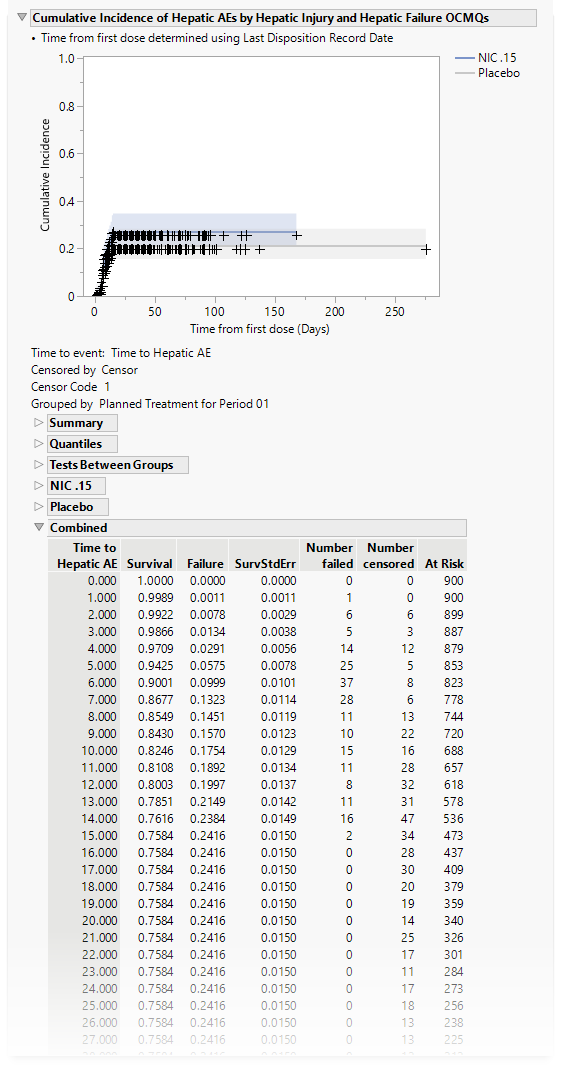

Cumulative Incidence of Hepatic AEs by Hepatic Injury and Hepatic Failure OCMQs
The plot in this section shows the cumulative incidence of liver-related adverse events for subjects in each treatment arm over the course of the treatment regime. It includes both unique as well as recurrent incidences.
The tables summarize by day the number of patients either failing or being censored. Tables show either combined results or results divided by treatment arm.

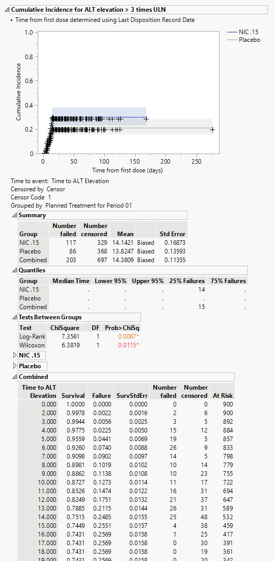

Cumulative Incidence for ALT Elevation > 3 times ULN
The plot in this section shows the cumulative incidence of ALT elevation above 3x ULN for subjects in each treatment arm over the course of the treatment regime. It includes both unique as well as recurrent incidences. Note: You can specify an alternate value for the comparator using the ALT Elevation greater than option.

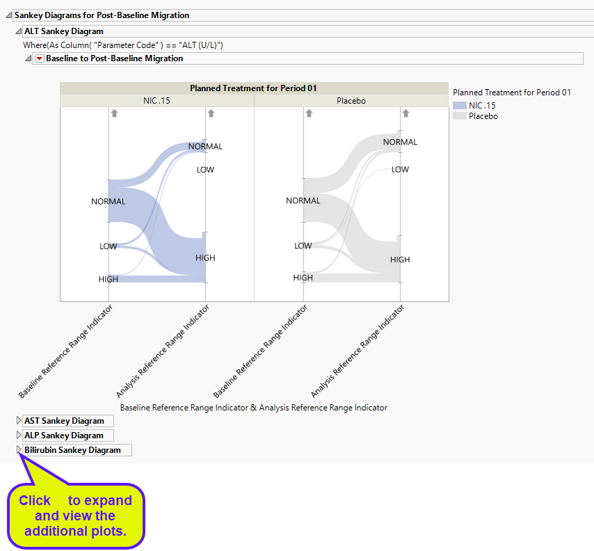

Sankey Diagrams for Post-Baseline Migration
This plot displays the shift of liver injury enzyme measurements from baseline reference range to on trial reference ranges of the subjects by treatment arm. Subjects are colored by treatment group.

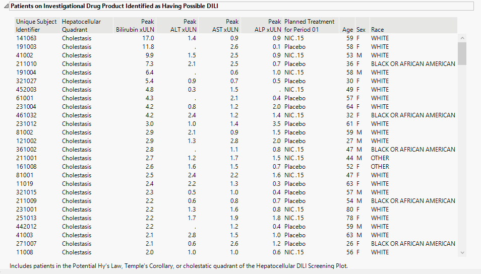

Patients on Investigational Drug Product Identified as Having Possible DILI
Contains a table listing subjects in treatment arm that are exhibiting possible DILI. Table diagnosis, peak indicator values, and demagraphic information for each affected subject.

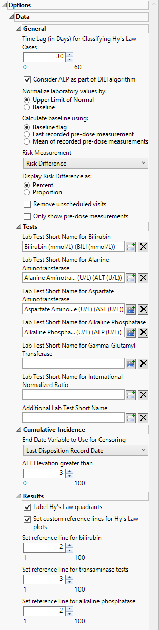

Options
Data
Time Lag (in Days) for Classifying Hy's Law Cases
Use this option to specify a lag time for classifying a subject as a Hy's Law case. See Time Lag (in Days) for Classifying Hy’s Law Cases for more information.
Consider ALP as part of the DILI algorithm:
Use this option to include the ALP test measurements when determining whether a patient meets Hy's Law criteria.to determine possible Hy's law cases. See Consider ALP as part of the DILI algorithm for more information.
Normalize laboratory values by:
You can choose to normalize the measurements by either the ULN or the baseline measurements for each test. You can select either the last pre-dose values or the means of all pre-dose values as the baseline See Normalize laboratory values by: for more information.
Calculate baseline using:
Use this option to specify how the baseline findings measurements should be calculated for normalization. See Calculate baseline using: for more information.
Risk Measurement
You have the option of calculating either the Risk Difference, the Relative Risk, or the Odds Ratio as the Risk Measurement.
Display Risk Difference as:
Use this widget to specify the difference between the risk of an event in the treatment arm and the control arm as either a percentage or a proportion of the total subject population. This widget appears only when you select Risk Difference as the Risk Measurement.
Remove unscheduled visits
You can restrict the analysis to data from scheduled visits by checking the Remove unscheduled visits box.
Only show predose measurements
Check this option to exclude all on-trial measurements from the analysis. This option enables you to observe all subjects at baseline.
Lab Test Short Name for Bilirubin
The Lab Test Short Name for Bilirubin option enables you to specify a non-standard test name for the bilirubin test. If this option is left blank, JMP Clinical uses the standard test designation.
Lab Test Short Name for Alanine Aminotransferase
The Lab Test Short Name for Alanine Aminotransferase option enables you to specify a non-standard test name for the alanine aminotransferase test. If this option is left blank, JMP Clinical uses the standard test designation.
Lab Test Short Name for Aspartate Aminotransferase
The Lab Test Short Name for Aspartate Aminotransferase option enables you to specify a non-standard test name for the aspartate aminotransferase test. If this option is left blank, JMP Clinical uses the standard test designation.
Lab Test Short Name for Alkaline Phosphatase
The Lab Test Short Name for Alkaline Phosphatase option enables you to specify a non-standard test name for the alkaline phosphatase test. If this option is left blank, JMP Clinical uses the standard test designation.
Lab Test Short Name for Gamma-Glutamyl Transferase
The Lab Test Short Name for Gamma-Glutamyl Transferase option enables you to specify a non-standard test name for the gamma-glutamyl transferase test. If this option is left blank, JMP Clinical uses the standard test designation.
Lab Test Short Name for International Normalized Ratio
The Lab Test Short Name for International Normalized Ratio option enables you to specify a non-standard test name for the international normalized ratio. If this option is left blank, JMP Clinical uses the standard designation.
Additional Lab Test Short Name
The Additional Lab Test Short Name option enables you to specify an additional test to be included in the analysis.
End Date Variable to Use for Censoring
Use the End Date Variable to Use for Censoring option for specifying the end date for censoring. Options include the date of the last disposition (selected by default) and the record reference end date.
By default, ALT levels equal to or greater 3*Upper Limit of Normal (ULN) are considered as events for the cummulative incidence screen. ALT levels below this values are not. You can change the value of this cutoff using the ALT Elevation greater than option. Values are expressed as multiples of the ULN.
Label Hy's Law quadrants
Selecting Label Hy’s Law quadrants places identifying labels, relating to Hy’s law, in each quadrant of all of the plots of bilirubin versus alanine aminotransferase.
Set custom reference lines for Hy's Law plots
Use the Set custom reference lines for Hy’s Law plots option to draw reference lines on the Hy’ Law plots. You must then specify reference lines for bilirubin, the transaminases, and alkaline phosphatase.
Set reference line for bilirubin
By default, the reference value for bilirubin is set to 2 or twice the ULN. You must then use the Set reference line for bilirubin option to specify an alternative value by which to multiply the ULN for bilirubin.
Set reference line for transaminase tests
By default, the reference value for the transaminase tests is set to 3 or 3x the ULN. You must use the Set reference line for transaminase tests option to specify an alternative value by which to multiply the ULN for alanine and/or aspartate transaminase.
Set reference line for alkaline phosphatase
By default, the reference value for alkaline phosphatase is set to 2 or twice the ULN. You must then use Set reference line for alkaline phosphatase option to specify an alternative value by which to multiply the ULN for alkaline phosphatase.
