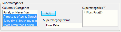

Select Column Properties > Supercategories.
5.
Click Add to create the supercategory.
6.
From the Supercategories red triangle menu, select from the following options:
Options > Hide: Hides data in the selected supercategory from reports and graphs.
Add All: Creates a supercategory from all of the categories in the column.
Add Mean and Add Std Dev: Calculate statistics for value scores. See the Consumer Research book for more information.
7.
Click OK to add the property to the column.
Figure 4.5 Example of a Supercategories Configuration

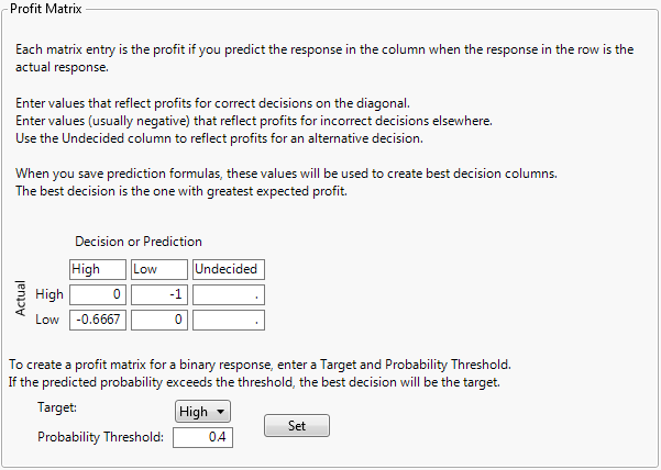

When you select Column Properties > Profit Matrix, a matrix template appears, with a row and column for each value in the selected column. The Actual levels are shown as rows and the predicted levels are shown as columns. Correct decisions are those on the diagonal, where the predicted level equals the actual level.
Enters values into the profit matrix template that reflect your specifications for Target and Probability Threshold. For details, see Probability Threshold Calculations.
Denote the threshold probability by t. When you click Set, the entries in the profit matrix are assigned as follows:
-t/(1 - t) for a prediction of the non-target level when the actual value is the target level

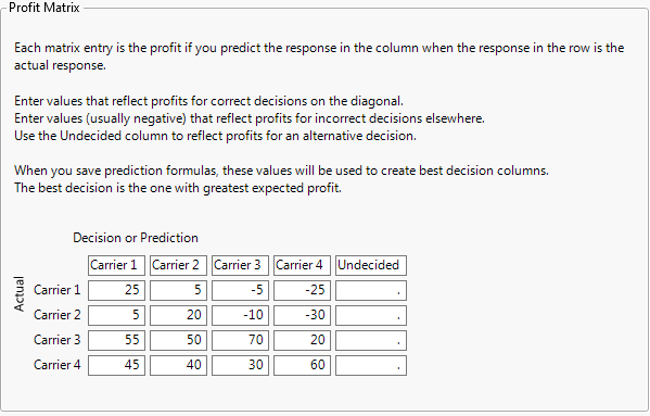

The example below (Figure 4.7) shows a profit matrix for the Airline column in the Travel Costs.jmp sample data table.
Figure 4.7 Example of Profit Matrix Window
To see how the values in this profit matrix were assigned, consider a travel agency that uses four airlines, Carrier 1 to Carrier 4, to service its customers. For each ticket sold, the agency realizes a profit that depends on the carrier selected by the customer. When the agency recommends, or predicts, a carrier, it reserves a ticket for a small fee. If the customer decides to use the predicted carrier, the agency profits by a certain amount less the reservation fee. However, if the customer decides to take a different carrier, the agency loses the reservation fee and must pay another reservation fee. The agency’s profit is lower due to the incorrect prediction.
The sample data table Liver Cancer.jmp gives disease Severity ratings for 136 patients. You are interested in modeling Severity using the predictors given in the columns from BMI to Jaundice. The usual prediction formulas for a model classify a patient into the Severity level that is most probable. However, classifying a patient as having Low severity when in actuality the patient’s severity is High is a more costly error than classifying a patient as having High severity when in actuality the patient’s severity is Low. As a result, you want to assign a higher cost to misclassifying a patient as Low, when the patient’s severity is actually high.
You can assign this higher cost by setting a probability threshold. With input from experts, you determine that the following is a good strategy: Classify into the High level of Severity any patient whose predicted probability of being in the High level exceeds 0.4.
Select the Severity column and select Cols > Column Info.
Change the Target to High.
5.
Enter 0.4 as the Probability Threshold.
6.
Click Set.
