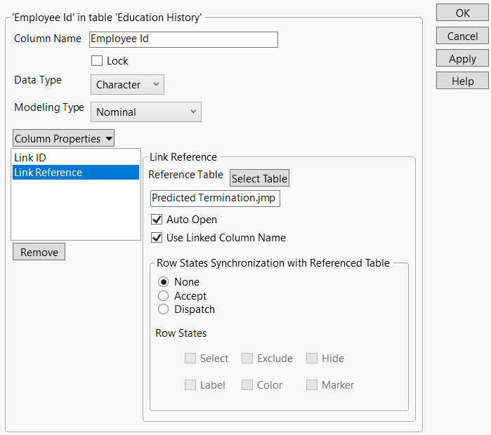

• You can also increase portability by using a JMP path variable in the Link Reference path. Figure 5.9 shows an example. Enter a forward slash in the path to share the data tables with both Windows and macOS users. See Path Variables in the Scripting Guide for more information about path variables.

Figure 5.9 Link Reference Column Property Definition
