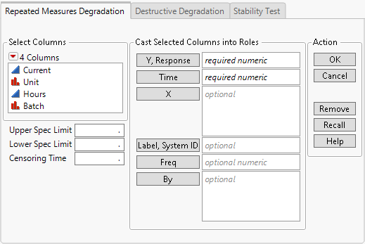

Launch the Degradation platform by selecting Analyze > Reliability and Survival > Degradation. Figure 7.3 shows the Degradation launch window using the GaAs Laser.jmp data table (located in the Reliability folder). For more information about the options in the Select Columns red triangle menu, see Column Filter Menu in Using JMP.
Figure 7.3 The Degradation Launch Window

The launch window is split into three tabs, representing three different types of analyses:
Repeated Measures Degradation
Performs linear or nonlinear degradation analysis. This option allows only one Y, Response variable. It does not allow censoring.
Destructive Degradation
Choose this type of analysis if units are destroyed during the measurement process. This option allows censoring. See Destructive Degradation.
Note: The Destructive Degradation platform provides a flexible collection of predefined models for destructive testing. See Destructive Degradation.
Stability Test
Performs a stability analysis for setting pharmaceutical product expiration dates. This option allows only one Y, Response variable. See Stability Analysis.
