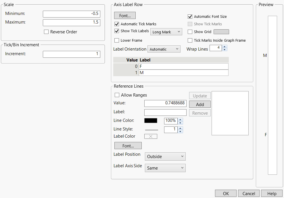

Double-click a numeric axis to customize it using the Axis Settings window. Or, right-click the axis area and select Axis Settings to access the window.
Note: In the Graph Builder and Distribution platforms, you can also customize nominal axes using the Axis Settings window.
Customization features in the window depend on the data type of the axis and the specific platform JMP uses to create the plot or chart. Figure 9.26 shows a typical Axis Settings window for numeric (continuous) axes.
Figure 9.26 Axis Settings Window for a Numeric (Continuous) Axis
The Axis Settings window contains the following panels:
• Scale
• Tick/Bin Increment
• Axis Label Row
• Reference Lines
• The Preview panel shows how your current selections will appear on the axis.

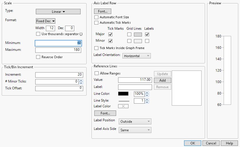

Scale
In the Scale panel, you can do the following:
• Change the Axis Scale Type
• Change the Numeric Format of an Axis
• Establish Minimum and Maximum Axis Values
For plots and charts that contain a numeric axis area, you can change the minimum and maximum values that you want the graph to display.
Note the following:
• To restore the default minimum, maximum axis settings, and tick increments of an axis, right-click on the axis labels and select Revert Scale. To restore all default axis settings, right-click the axis labels and select Revert Axis.
• Select Reverse Order to reverse the axes by reversing the minimum and maximum values. Note that this option is not supported for ternary plots.
Tip: To set a default minimum and maximum axis value for a variable, which avoids making this change every time you run an analysis, see Axis.

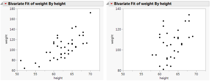

The example on the right in Figure 9.27 is an enlargement of the point cluster that shows between 80 and 140 in the plot to the left. The enlarged plot is obtained by reassigning the maximum and minimum axis values.
Figure 9.27 Rescale Axis to Enlarge a Plot Section

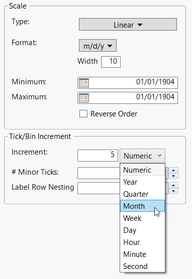

Change Axis Increments
While viewing a graph, you can change the axis increments.
If the axis Format is set to Date, Time, or Duration, a format menu appears beside Increment (Figure 9.28). Select the format for the increments.
Figure 9.28 Selecting the Format for Date and Time Increments
Tip: To set a default axis increment for a variable, which avoids making this change every time you run an analysis, see Axis.

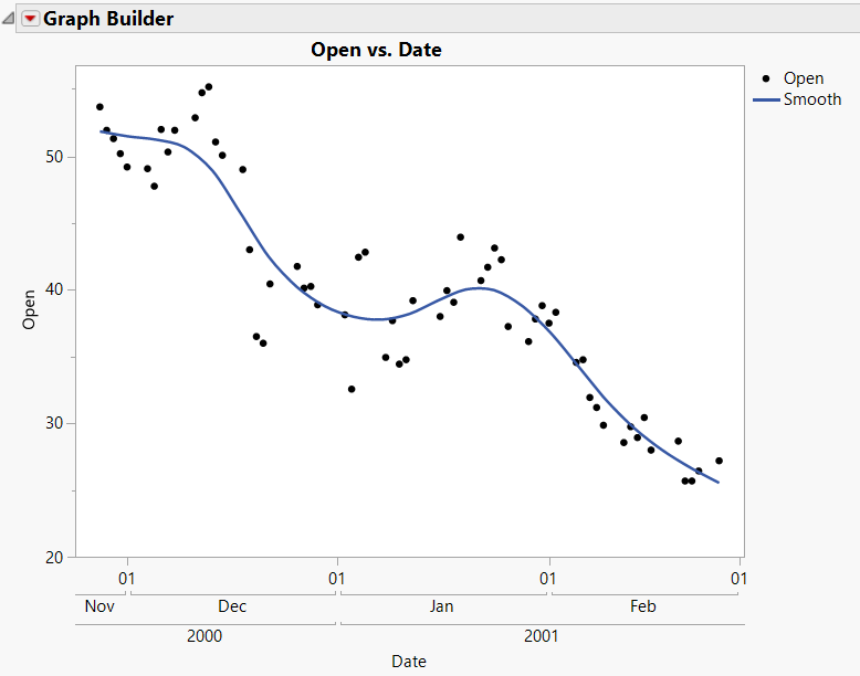

Label Row Nesting
This option appears only if you have selected Date, Time, or Duration as the axis Format. Label row nesting enables you to split a date axis into multiple rows based on the format. For example, you might put the year on the outermost row, then the month, then the day:
1. Select Help > Sample Data Library and open Stock Prices.jmp.
3. Drag Date into the X zone.
4. Drag Open into the Y zone.
5. Double-click the X axis.
6. For Format, select Date > ddMonyyyy.
7. Increase the value for Label Row Nesting to 3.
8. Click OK.
9. Click Done to see the finished graph.
Figure 9.29 Example of Label Row Nesting

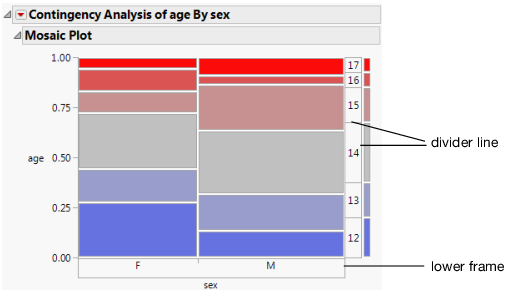

Extend Divider Lines and Frames for Categorical Axes
Extending the vertical divider line(s) between tick labels is useful when there are many levels of a nominal or ordinal (categorical) variable.
To extend the divider line to the x-axis labels, follow these steps:
1. Double-click a nominal or ordinal axis to show the axis settings.
2. Select Show Tick Marks > Short Divider of Show Tick Marks > Long Divider to add the divider lines, or Lower Frame to add a frame around the axis area.
Figure 9.31 Divider Lines
Divider Lines
