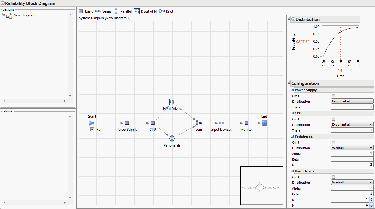

The Reliability Block Diagram platform displays the reliability relationships among a system's components. If reliability distributions are assigned to the components, the platform analytically models the reliability behavior. A Reliability Block Diagram (also known as a dependence diagram) illustrates how component reliability contributes to the success or failure of a system.
Figure 11.1 Example of a Reliability Block DiagramĀ
