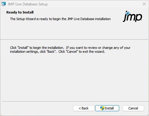

Figure 1.4 Start JMP Live Database Installation
5.
Click Install.
6.
Click Finish once the installer is done.

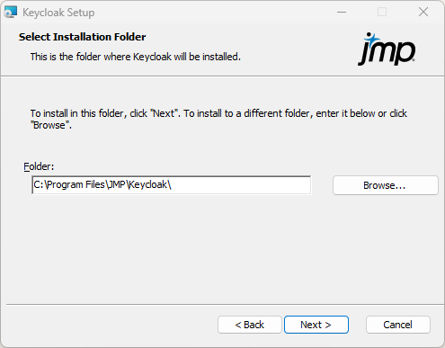

Figure 1.7 Specify the Keycloak Install Location
Specify where you want to put the Keycloak installation files, and then click Next.
Note: The Keycloak files are placed in a subfolder in the install directory. This subfolder cannot be moved or changed.

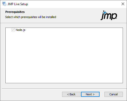

Figure 1.20 Select Prerequisites to Install
Node.js is selected by default and must be installed.
6.
Click Next.

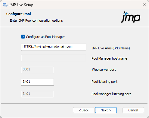

Note: If you are installing for the worker pool architecture, select the JMP Pool Manager component, and skip to step 16. For more information, see About JMP Live Architecture and Authentication.
10.

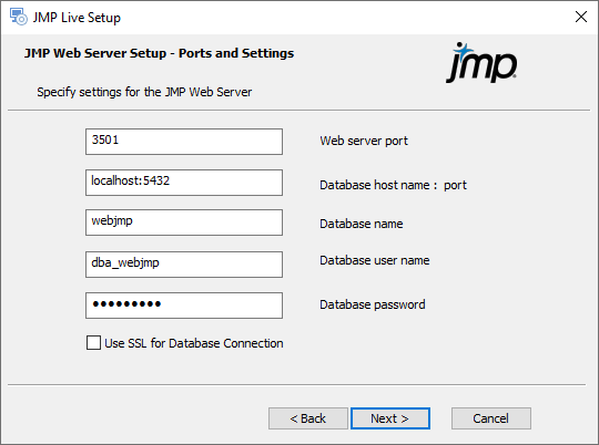

Figure 1.24 Specify Ports and Database Details
11.
Specify the following JMP web server settings:
Web server port: Enter the HTTPS port that will take requests from a browser. By default, this port is set to 3501. You can specify port 443 (the default HTTPS port), but it is recommended to use a dedicated port for easier monitoring and access control. If you install an application load balancer in front of the web server component, specify this port.
Database host name: port:
Enter the DNS name of the machine that is running the PostgreSQL database for JMP Live. The default name is localhost (the install machine), but typically this would specify a dedicated server running PostgreSQL. This machine could be within a corporate firewall, outside the firewall, or in a cloud service.
Enter the port that was specified during the installation of PostgreSQL for communication from the outside. The default PostgreSQL port is 5432. See Figure 1.3.
Database name: Enter the name assigned to the JMP Live database within PostgreSQL. It is possible to change this name, but not recommended, as the database installer defaults to webjmp.
Database user name and Database password: Enter the administrator user ID and password that you specified while installing the JMP Live Database. The Database user name should be dba_webjmp, but you likely changed the password from the default (which is Password1). Enter that password here.
Use SSL for Database Connection: Select this option if your PostgreSQL database requires SSL encrypted communications.

Figure 1.28 Configure the Pool Manager
16.
If you want to run the Pool Manager on this machine, select the Configure as Pool Manager box:
If you are using one machine for all components, or one machine for the Pool Manager and JMP sessions, select this option.
If you are using this machine for a worker pool only, do not select this option.
17.
Specify the Pool Manager options:
JMP Live Alias (DNS Name): Enter the DNS name, which typically looks like this: machine name.domain name.com/org. Note the following:
Unless you are installing all components using the localhost option, you need to specify the web host name.
Even if you have all components on one machine, you likely want to use your organization's SSL certificates for a secure connection. In that case, specify the machine name as the web host name, since the certificates are usually tied to the machine.
Pool Manager host name: (Disabled if you are selected Configure as Pool Manager.) If you are setting up a worker pool on a separate machine, enter the DNS name of the machine that is handling the Pool Manager duties.
Web server port: (Disabled if you are installing all components on the same machine, as the port number is already specified in the JMP web component.) If you are installing only the JMP Pool component, enter the port that you used when installing the JMP web component on another machine.
Pool listening port: Enter the port that this pool is listening on for communication from the JMP Pool Manager and JMP web components.
Pool Manager listening port: (Enabled only if you are configuring a worker pool.) Enter the port that was specified as the Pool listening port for the JMP Pool Manager setup. The worker pool needs to know this port in order to tell the JMP Pool Manager that it is available.
