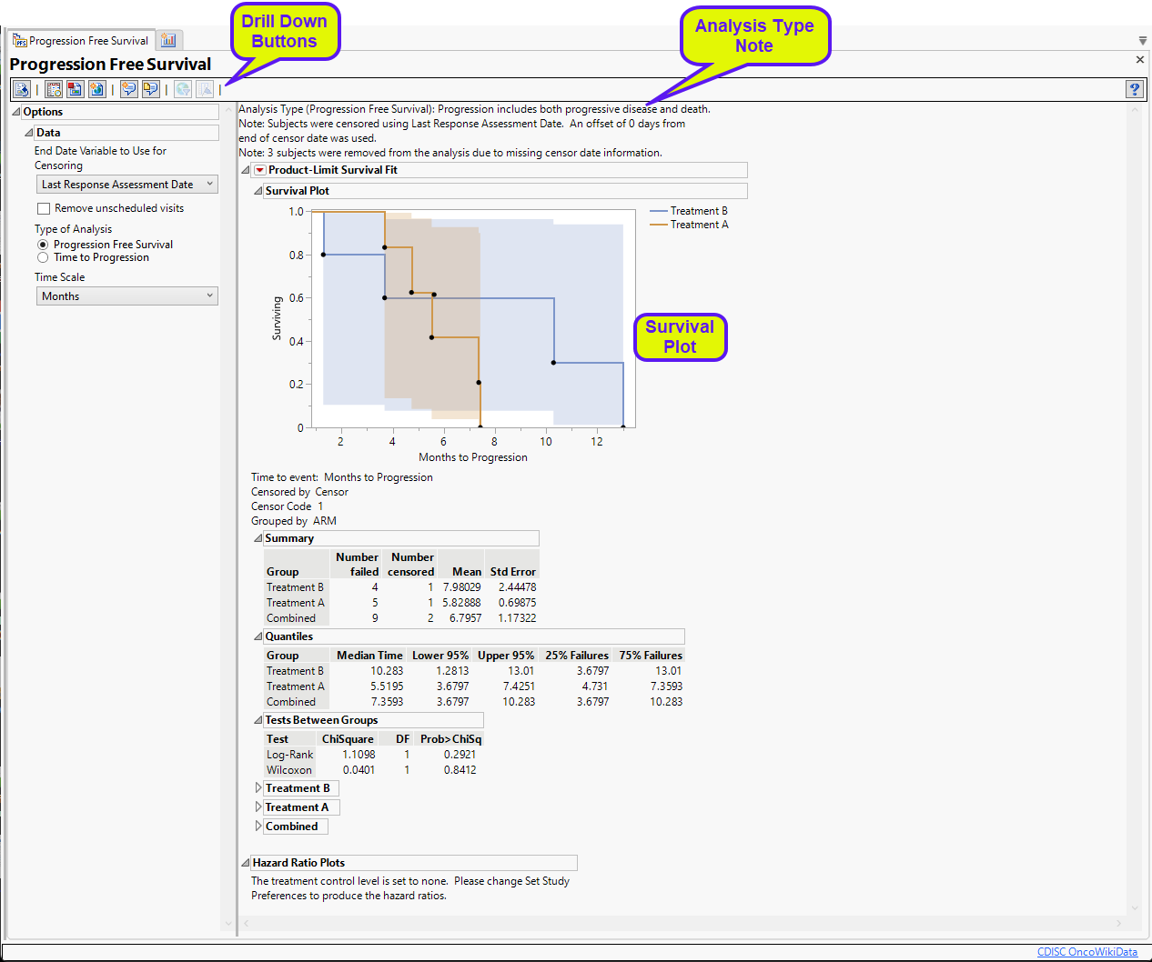

Report Results Description
Running this report for a modified Nicardipine study using default settings generates the report shown below.
It contains the following elements:
| • | Summary text |
Summarizes the subjects plotted below.
| • | One Survival Plot |
This plot shows the probability of patients showing no disease progression over the course of the study. The plateaus indicate that the probability of not progressing remains the same during that period. The dots indicate that patients have either shown disease progression or have left the study (withdrawal or death). The connecting lines are colored by treatment.
| • | Associated Summary tables |
The tables summarize the response and statistics of patients receiving the treatment or control.

| • | Click to rerun the report using default settings. |
| • | Click to view the associated data tables. Refer to Show Tables for more information. |
| • | Click to generate a standardized PDF- or RTF-formatted report containing the plots and charts of selected sections. |
| • | Select one or more subjects, then click to apply the Review Subject Filter and filter all reports in the review builder on the selected subjects. |
| • | Select a group of subjects and click to specify Derived Population Flags that enable you to distinguish the selected group of subjects from the general population. |
