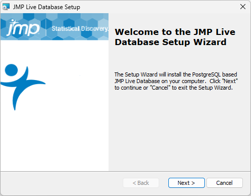

Double-click JMPLiveDatabase.msi.
This file is located in the ZIP file that you downloaded from JMP.
Figure 1.1 JMP Live Database Setup Wizard
Click Next.

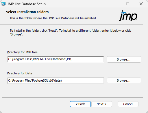

Figure 1.2 Specify Installation Folders
Specify where to install the JMP Live database and the PostgreSQL database:
Click Next to accept the default location.
Click Browse to change the default installation folder.
Note: Make sure you have adequate space in the directory where you install the PostgreSQL database.

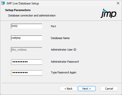

Figure 1.3 Specify Database Parameters
Enter these parameters:
Note: If you are upgrading, ensure that these parameters match what is in your JMP Live environment file. For details, see (Optional) Configure Advanced Settings.
Port: The TCP port that PostgreSQL uses to communicate with other databases. This is usually 5432. If you are upgrading from PostgreSQL 14, this port must be different from the previous database port number. In this case, 5433 is recommended.
Database Name: The name of the default database that JMP Live uses. It is recommended to keep this set to webjmp. The administrator user ID cannot be changed from dba_webjmp.
Administrator Password: The administrator password, which is Password1 by default. It is strongly recommended that you change this password.
Note: Allowable characters are A-Z, a-z, 0-9, and ;,/?:@&=+$#-_!~*().

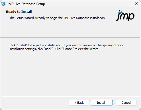

Figure 1.4 Start JMP Live Database Installation
5.
Click Install.
6.
Click Finish once the installer is done.

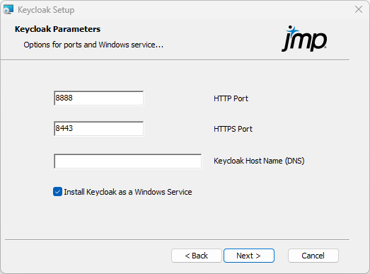

Figure 1.10 Configure Ports and Services
7.
Specify these Keycloak details:
HTTP port: Enter the HTTP network port. The default port is 8888. This port needs to be open to the Keycloak server.
HTTPS Port: Enter the HTTPS network port. The default port is 8443. This port needs to be open to the Keycloak server.
Keycloak Host Name (DNS): Enter the host name of the Keycloak server.
Install Keycloak as a Windows Service: Select this option to install Keycloak as a Windows service. This means that Keycloak is automatically started, and if the machine reboots it automatically restarts, so that Keycloak is always running. If you do not select this option, you must start Keycloak manually the first time and anytime the machine is rebooted. This option is selected by default, and it is recommended to keep it selected.
8.
Click Next.

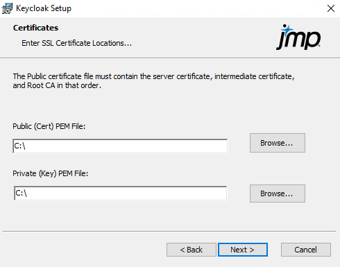

Figure 1.11 Specify Keycloak Certificates
Keycloak requires SSL certificates to guarantee your organization's authenticity and to allow secure connections between Keycloak and identity providers.
Caution: Installation fails if you do not specify these certificates.
9.
Specify the locations of your organization’s SSL certificates. These must be obtained from an authorized provider.
SSL certificates are text files containing cryptographic keys that enable a browser and the web server to have secure communication. These keys are specific to an organization and are provided by third-party vendors like DigiCert, Symantec, and Network Solutions. JMP Live cannot run without these certificates.
The Public key must point to a file that contains the certificate, intermediate certificate, and root certificate, concatenated in that order.
The Private key file is supplied by the third-party vendor that provided the Public key certificate.

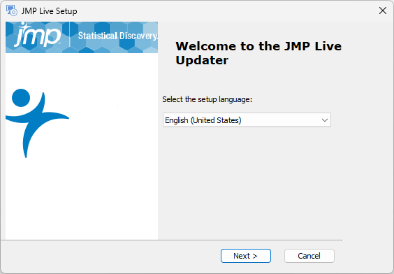

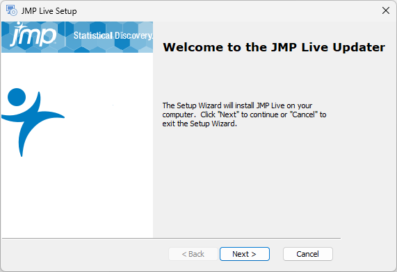

Double-click JMPLive.exe.
Figure 1.16 Select Your Setup Language
Select your setup language, and then click Next.

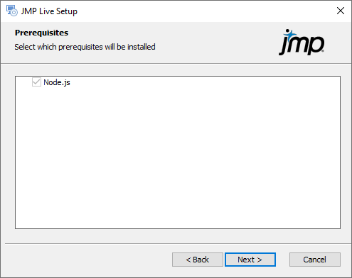

Figure 1.19 Select Prerequisites to Install
Node.js is selected by default and must be installed.
6.

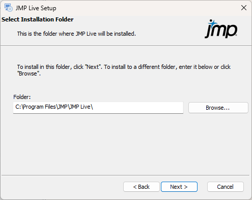

Figure 1.21 Specify Installation Folder
8.
Specify where to install JMP Live:
Click Next to accept the default location (recommended).
If you change the default location, note the following:
The changed folder contains the JMP Live installation files, but PostgreSQL is always installed in its default location.
Since JMP Live can generate log information, make sure that there is adequate disk space in the new location. 1 gigabyte is the recommended minimum.

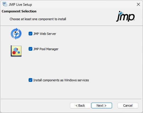

Figure 1.22 Component Selection Window
9.
Select the components that you want to install on this machine (you must select at least one):
If you want to install both components on this machine, keep both selected.
If you want to distribute the components across different machines, select the component that you want to install on this machine. You must run the installer on the other machine to install the other option.
Note: If you are installing for the worker pool architecture, select the JMP Pool Manager component, and skip to step 16. For more information, see About JMP Live Architecture and Authentication.
10.
(Optional) Choose whether to install the selected components as Windows services.
If you choose this option, note the following:
JMP Live runs in the background whether you are logged in or not.
If a machine is rebooted, the services for JMP Live automatically restart.

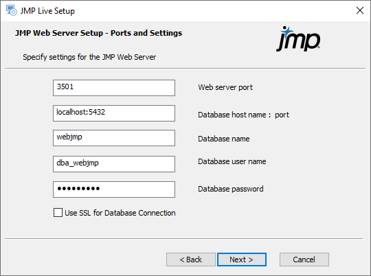

Figure 1.23 Specify Ports and Database Details
11.
Specify the following JMP web server settings:
Web server port: Enter the HTTPS port that will take requests from a browser. By default, this port is set to 3501. You can specify port 443 (the default HTTPS port), but it is recommended to use a dedicated port for easier monitoring and access control. If you install an application load balancer in front of the web server component, specify this port.
Database host name: port:
Enter the DNS name of the machine that is running the PostgreSQL database for JMP Live. The default name is localhost (the install machine), but typically this would specify a dedicated server running PostgreSQL. This machine could be within a corporate firewall, outside the firewall, or in a cloud service.
Enter the port that was specified during the installation of PostgreSQL for communication from the outside. The default PostgreSQL port is 5432. See Figure 1.3.
Database name: Enter the name assigned to the JMP Live database within PostgreSQL. It is possible to change this name, but not recommended, as the database installer defaults to webjmp.
Database user name and Database password: Enter the administrator user ID and password that you specified while installing the JMP Live Database. The Database user name should be dba_webjmp, but you likely changed the password from the default (which is Password1). Enter that password here.
Use SSL for Database Connection: Select this option if your PostgreSQL database requires SSL encrypted communications.

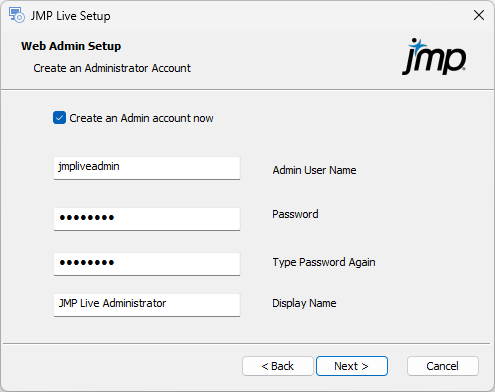

Figure 1.24 Create an Administrator Account
Note: It is strongly recommended that you create an administrator account. However, if you are updating JMP Live from a previous version and already have an administrator account in the database, then you can safely skip this step by deselecting the Create an Admin account now box.
12.
Enter the administrator user name that you will log on to JMP Live with. Provide a password (default is password) and a display name that will appear when you post content to JMP Live. Note the following:
The Admin User Name must not contain spaces and must be lowercase.
Once you create an administrator account, you can log on to this account and designate other users as administrators.
You can create an administrator account at any time using a command line interface. See Maintain the JMP Live Database.

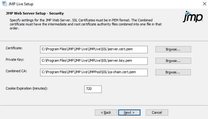

Figure 1.25 Specify SSL Certificates
13.
Navigate to or enter the SSL certificates for your organization.
The primary certificate and private key are configured for the purchaser. The Combined CA comes from a third-party vendor and is a single file that contains the intermediate and root certificate (in that order).
The JMP Live installer provides a certificate set that allows for minimal testing on a localhost setup. However, it generates warnings when the site is viewed in the local browser, and the site is inaccessible from browsers outside the install machine.
Tip: You can validate the SSL certificates after the JMP Live installation is complete. See Validate SSL Certificates for JMP Live. To run the SSL certificate validation utility, from a node.js command line, enter the following directory and command: C:\Program Files\JMP\JMP Live\JMPLive>npm run check-ssl.
14.
Cookie Expiration: Specify how long the JMP web component remembers that you signed in to JMP Live.
The default value is 720 minutes (12 hours) but you can shorten this for increased security.
Cookie Expiration is not the same as an idle time-out. You can be using the site constantly, but the cookie expiration forces you to sign in again after it expires.

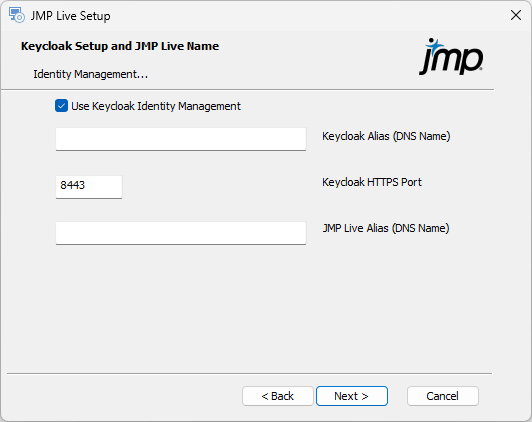

Figure 1.26 Set Up Keycloak
15.
Specify the following Keycloak settings:
Use Keycloak Identity Management: Enables the Keycloak authentication system. If you deselect this option, Local authentication is used. In this case, users need to create accounts in JMP Live. These users are not authenticated against different identity providers. For details about connecting Keycloak to your identity provider, see the Keycloak documentation.
Keycloak Alias (DNS Name): Specify the name of the server machine that is running the Keycloak authentication service.
Keycloak HTTPS Port: Specify the number of the port that Keycloak expects to receive requests on. The default port is 8443.
JMP Live Alias (DNS Name): Specify the name of the machine that will run the main JMP Live site.

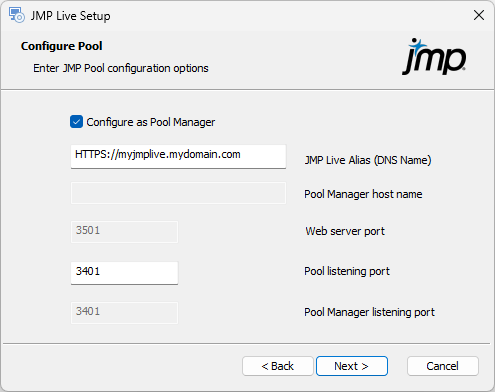

Figure 1.27 Configure the Pool Manager
16.
If you want to run the Pool Manager on this machine, select the Configure as Pool Manager box:
If you are using one machine for all components, or one machine for the Pool Manager and JMP sessions, select this option.
If you are using this machine for a worker pool only, do not select this option.
17.
Specify the Pool Manager options:
JMP Live Alias (DNS Name): Enter the DNS name, which typically looks like this: machine name.domain name.com. Note the following:
Unless you are installing all components using the localhost option, you need to specify the web host name.
Even if you have all components on one machine, you likely want to use your organization's SSL certificates for a secure connection. In that case, specify the machine name as the web host name, since the certificates are usually tied to the machine.
Pool Manager host name: (Disabled if you are selected Configure as Pool Manager.) If you are setting up a worker pool on a separate machine, enter the DNS name of the machine that is handling the Pool Manager duties.
Web server port: (Disabled if you are installing all components on the same machine, as the port number is already specified in the JMP web component.) If you are installing only the JMP Pool component, enter the port that you used when installing the JMP web component on another machine.
Pool listening port: Enter the port that this pool is listening on for communication from the JMP Pool Manager and JMP web components.
Pool Manager listening port: (Enabled only if you are configuring a worker pool.) Enter the port that was specified as the Pool listening port for the JMP Pool Manager setup. The worker pool needs to know this port in order to tell the JMP Pool Manager that it is available.

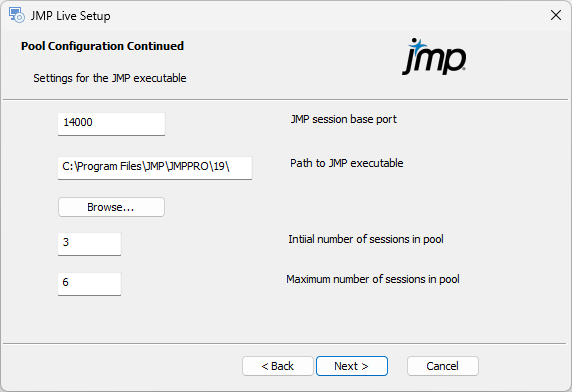

Figure 1.28 Configure JMP Settings
JMP needs to be installed using its own installer on all machines that support creating JMP sessions, whether that is part of the JMP Pool Manager or the worker pool. These sessions of JMP will be started to do work for JMP Live when reports are modified.
18.
Specify these JMP details:
JMP session base port: Enter the base port used by the JMP sessions to talk with the JMP Pool Manager. Each instance of JMP has a unique number starting with this base number.
Path to JMP executable: Enter the path to the JMP Pro location. The default installation path appears, so you need to change this only if JMP Pro is located elsewhere.
Initial number of sessions in pool: Enter the number of JMP sessions that will be started when the pool is first run.
Maximum number of sessions in pool: Enter the upper limit for the number of JMP sessions that are allowed to run on this machine as part of this pool. These sessions are added if the number specified in the initial number of sessions are all in use.
Note: If you are installing the Pool Manager, and only want it to handle resource allocation to other worker pools, you can set both the initial and the maximum numbers to zero. In this case, the site will not function until worker pools are configured and running.

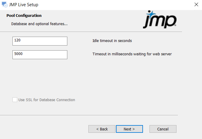

Figure 1.29 Configure JMP Settings
19.
Idle timeout in seconds: Enter the length of time that a JMP instance waits for additional work before dropping the connection with the JMP web component and waiting for a new request.
Timeout in milliseconds waiting for web server: Enter how long an instance waits for further communication during an existing transaction before it gives up and discards the existing work request.
SSL Combined Intermediate and Root Certificate file in PEM format: (Appears if you are installing the JMP Pool Manager component only) Specify the location of the certificate file that combines the Intermediate and Root certificates (in that order).

Upgrade JMP Live
If you have an existing installation of JMP Live, you can quickly upgrade to the next minor version.
Installation procedure
Figure 1.31 Select Your Setup Language
Figure 1.32 JMP Live Prerequisites Setup Wizard
Click Next.
Figure 1.33 Prerequisite Node.js selected
Click Next.

The facilities that JMP Live provides for authentication are based on the location of the installation. For an on-premises installation, JMP Live can connect to a Microsoft Active Directory endpoint if your organization supports Active Directory or LDAP (Lightweight Directory Access Protocol).
The authentication mechanisms covered here relate to how JMP Live connects to the user's identity providers. Communication between JMP and JMP Live is different.
Figure 1.40 JMP Live Authentication Options and Flow
Keycloak Application
The Keycloak application acts as a bridge to various authentication mechanisms. OpenID Connect (OIDC) is used between the JMP Client, JMP Live, and Keycloak to secure those transactions. The connection between Keycloak and the various authentication mechanisms depends on that mechanism, but it is often TLS.
Keycloak provides authentication session tokens to JMP Live and JMP. These tokens indicate whether the user is allowed to use JMP Live. The tokens also tell JMP Live when the authentication session has expired.
Use Active Directory or LDAP
To enable on-premises authentication using Active Directory or LDAP, you need to specify certain parameters in the environment file for the JMP web component.
Open the environment file for the JMP web component, located here (by default): C:\Program Files\JMP\JMP Live\JMPLive\.env.
If you have installed the JMP web component as a Windows service, use the Task Manager to stop the service before you update the environment file.
Specify these parameters in the .env file:
AUTH_SCHEME=ldap
This specifies the authentication method as LDAP or Active Directory.
LDAP_URL="ldap://site_ldap_endpoint.mycompany.com:port#"
This is the communication endpoint for the Active Directory requests, where port# is the 4-digit port used for the Active Directory communications. The connection must be direct to the Active Directory or LDAP instance.
LDAP_BIND_DN="CN=COMPANY LDAP-Read,OU=Generic and Shared Accounts,OU=Admin,DC=mydepartment,DC=mycompany,DC=com"
This is the administrator account for the Active Directory binding. This is site specific. If your site does not allow for anonymous binding, this might be a domain-specific account.
LDAP_SEARCH_BASE="DC= mydepartment,DC= mycompany,DC=com"
This is the base domain from which to search for users by user name.
LDAP_BIND_CRED="abcd1234efgh"
This is the administrator account password
LDAP_SEARCH_FILTER=(samAccountName={{username}})(memberOF=CN=JMP Live User Group,OU=Groups,DC=mydepartment,DC=mycompany,DC=com))
The filter used to search for the user. The user name in {{}} is interpolated as the provided user name. You can use the memberOF option to validate that a user is in the group.
Save the .env file.
5.
If you have installed the JMP web component as a Windows service, use the Task Manager to restart the service once you finish updating the environment file.

Manually Connect Keycloak and Start JMP Live
After you install JMP Pro, the JMP Live Database, Keycloak and JMP Live, JMP Live and Keycloak should be automatically connected. If you have problems logging in to JMP Live after the installation, you might need to connect to Keycloak and start JMP Live manually.
If you are using the JMP Live database as the Keycloak database, run JMP Live once.
This populates the JMP Live database with the correct schemas and tables for Keycloak to operate.
If JMP Live is running as a Windows service, stop it:
a.
Type Task Manager in the Windows search bar. Or, press Ctrl+Alt+Delete and select Task Manager.
b.
Click the Services tab.
Tip: If you do not see the Services tab, you might need to click More Details.
c.
Right-click webjmpsvc.exe and jmppoolsvc.exe and click Stop.
Type Command Prompt in the Windows search bar. Run the command prompt as an administrator (right-click Command Prompt and choose Run as administrator).
Navigate to the JMPLive component installation directory. Enter: cd C:\Program Files\JMP\JMP Live\JMPLive (assuming that JMP Live is in the default directory).
5.
Edit the .env file using Notepad. Enter: start Notepad .env.
6.
In the .env file, verify the parameters in these lines:
AUTH_SCHEME=keycloak
Note: Alternative choices include ldap and local. ldap is the legacy choice to connect to LDAP or the Microsoft Active Directory (do not choose this option unless you are using JMP 15.0 or higher). local allows for a standalone authentication without connecting to an identity provider.
KEYCLOAK_SERVER_URL=https://mykeycloakserver.mydomain.com:8443
Where mykeycloakserver.mydomain.com:8443 is the URL of your Keycloak server and the port that allows HTTPS access.
JMPLIVE_BASEURL=https://myjmpliveinstance.mydomain.com:3501
Where myjmpliveinstance.mydomain.com:3501 is the DNS name or alias of your JMP Live server and the port that you are using for HTTPS access.
7.
Save the .env file updates. Click File > Save.
8.
Start the JMP Live components:
If you installed JMP Live as a Windows service, open the Task Manager, Services tab (refer to step 2) and start each JMP Live service. Right-click webjmpsvc.exe and jmppoolsvc.exe and click Start.
If you have not installed JMP Live as a Windows service, perform the steps under Components Not Installed as Windows Services.
JMP Live and Keycloak should now be working together.
