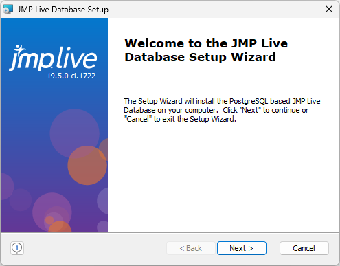

Figure 1.1 JMP Live Database Setup Wizard
Click Next.

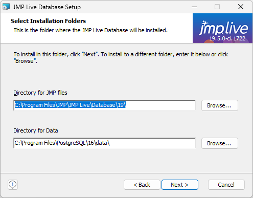

Figure 1.2 Specify Installation Folders
Specify where to install the JMP Live database and the PostgreSQL database:
Click Next to accept the default location.
Click Browse to change the default installation folder.

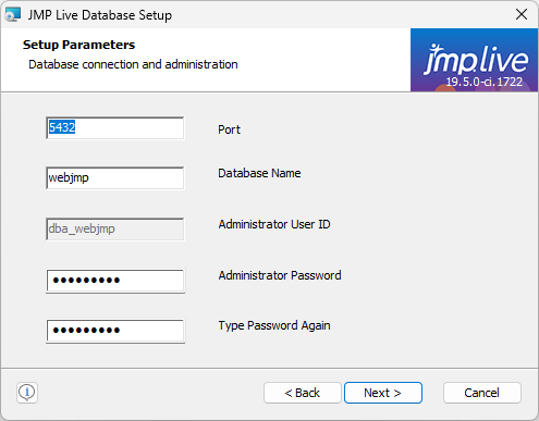

Figure 1.3 Specify Database Parameters
Enter these parameters:
Note: If you are upgrading, ensure that these parameters match what is in your JMP Live environment file. For details, see (Optional) Configure Advanced Settings.
Port: The TCP port that PostgreSQL uses to communicate with other databases. This is usually 5432. If you are upgrading from PostgreSQL 14, this port must be different from the previous database port number. In this case, 5433 is recommended.
Database Name: The name of the default database that JMP Live uses. It is recommended to keep this set to webjmp. The administrator user ID cannot be changed from dba_webjmp.
Administrator Password: The administrator password, which is Password1 by default. It is strongly recommended that you change this password.
Note: Allowable characters are A-Z, a-z, 0-9, and ;,/?:@&=+$#-_!~*().

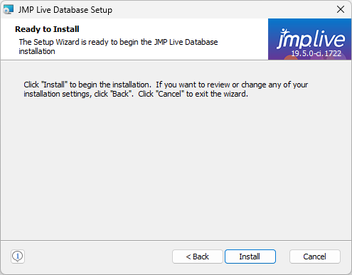

Figure 1.4 Start JMP Live Database Installation
5.
Click Install.
The PostgreSQL installer launches in a separate window.
6.
Click Finish once the installer is done.

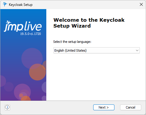

Figure 1.5 Select Your Setup Language
Select your setup language, and then click Next.

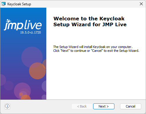

Figure 1.6 Keycloak Welcome Window
Click Next.

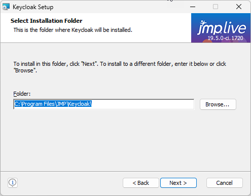

Figure 1.7 Specify the Keycloak Install Location
Specify where you want to put the Keycloak installation files, and then click Next.
Note: The Keycloak files are placed in a subfolder in the install directory. This subfolder cannot be moved or changed.

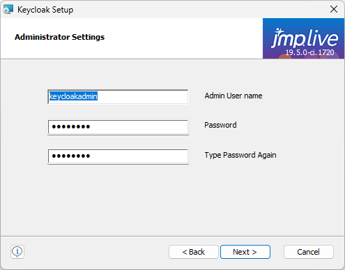

Figure 1.8 Set Up the Keycloak Administrator
5.
Specify the administrator credentials, and then click Next.
By default, the user name is keycloakadmin and the password is password. It is recommended to change the password.

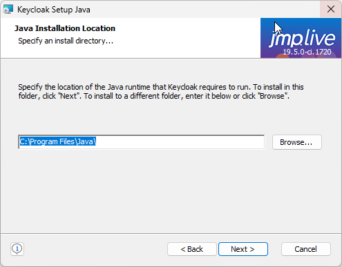

Figure 1.9 Specify the Java Install Location
During the Keycloak installation, the Azul Java distribution is also installed. If you already have this installed, no changes are made to your current installation.
6.
Specify the directory where you want to install Java, and then click Next.
Note: The installer adds a JAVA_HOME environment variable to the Windows advanced system settings.

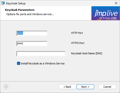

Figure 1.10 Configure Ports and Services
7.
Specify these Keycloak details:
HTTP port: Enter the HTTP network port. The default port is 8888. This port needs to be open to the Keycloak server.
HTTPS Port: Enter the HTTPS network port. The default port is 8443. This port needs to be open to the Keycloak server.
Keycloak Host Name (DNS): Enter the host name of the Keycloak server.
Install Keycloak as a Windows Service: Select this option to install Keycloak as a Windows service. This means that Keycloak is automatically started, and if the machine reboots it automatically restarts, so that Keycloak is always running. If you do not select this option, you must start Keycloak manually the first time and anytime the machine is rebooted. This option is selected by default, and it is recommended to keep it selected.
8.
Click Next.

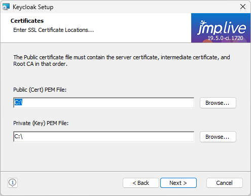

Figure 1.11 Specify Keycloak Certificates
Keycloak requires SSL certificates to guarantee your organization's authenticity and to allow secure connections between Keycloak and identity providers.
Caution: Installation fails if you do not specify these certificates.
9.
Specify the locations of your organization’s SSL certificates. These must be obtained from an authorized provider.
SSL certificates are text files containing cryptographic keys that enable a browser and the web server to have secure communication. These keys are specific to an organization and are provided by third-party vendors like DigiCert, Symantec, and Network Solutions. JMP Live cannot run without these certificates.
The Public key must point to a file that contains the certificate, intermediate certificate, and root certificate, concatenated in that order.
The Private key file is supplied by the third-party vendor that provided the Public key certificate.
10.
Click Next.

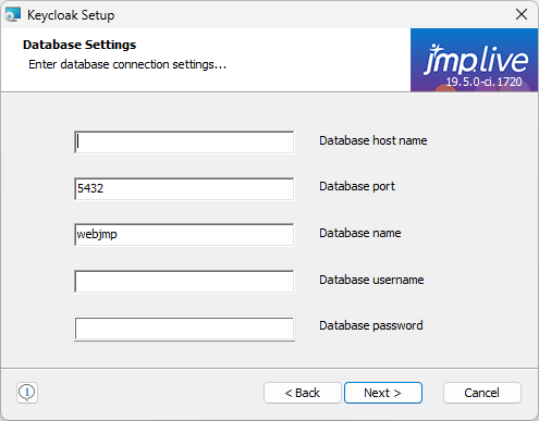

Figure 1.12 Configure Database Parameters
Keycloak stores information about users and clients in a database.
11.
Specify the database information:
Note: The following information should match what you entered when you installed the JMP Live database. See Install the JMP Live Database.
Database host name: Specify the alias or DNS name of the machine with the JMP Live database.
Database port: Specify the port that the database listens on.
Database name: Specify the name of the JMP Live database.
Database username: Specify the user name of the database administrator.
Database password: Specify the password of the database administrator.
12.
Click Next.

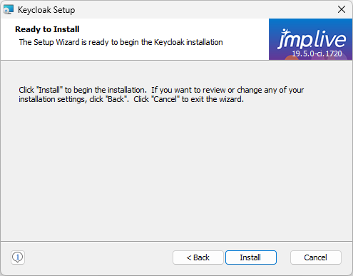

Figure 1.13 Ready to Install Keycloak
13.
Click Install to proceed.

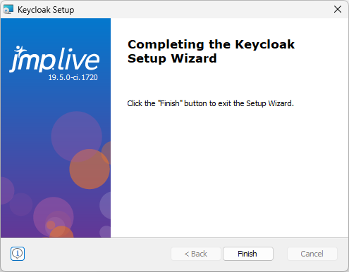

Figure 1.14 Completion Window
Completion Window
14.
Click Finish.
This process can take several minutes, since separate procedures run for Java and Keycloak. You see progress indicators and a command prompt.
If you selected Keycloak to run as a Windows service, Keycloak should be running when the installation finishes. Otherwise, to launch Keycloak manually, use this command:

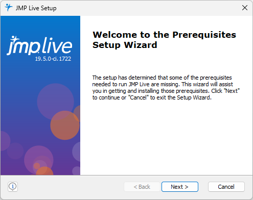

Figure 1.17 JMP Live Prerequisites Setup Wizard
Click Next.

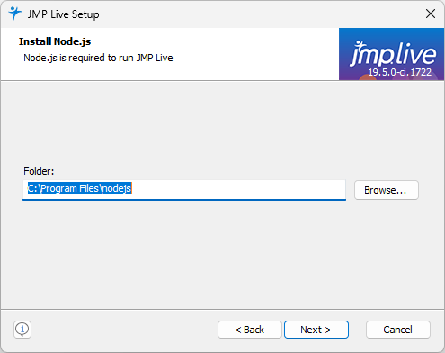

Figure 1.18 Select Installation Path for Node.js
5.
Specify where to install Node.js:
Click Next to accept the default location (recommended).

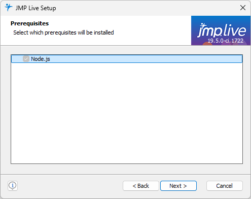

Figure 1.19 Select Prerequisites to Install
Node.js is selected by default and must be installed.
6.
Click Next.

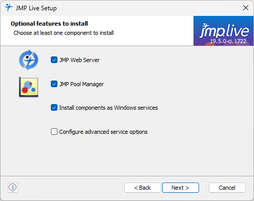

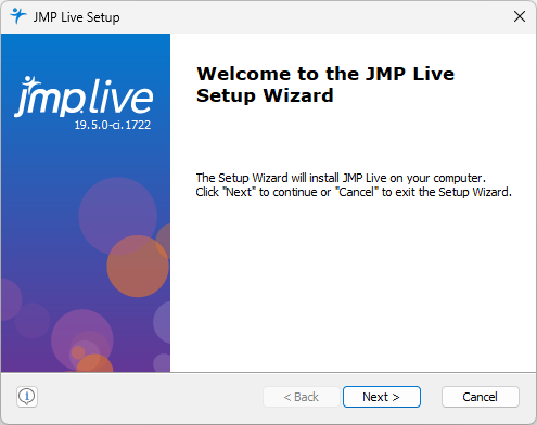

Figure 1.20 JMP Live Setup Wizard
7.
Click Next.

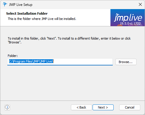

Figure 1.21 Specify Installation Folder
8.
Specify where to install JMP Live:
If you change the default location, note the following:
The changed folder contains the JMP Live installation files, but PostgreSQL is always installed in its default location.
Since JMP Live can generate log information, make sure that there is adequate disk space in the new location. 1 gigabyte is the recommended minimum.

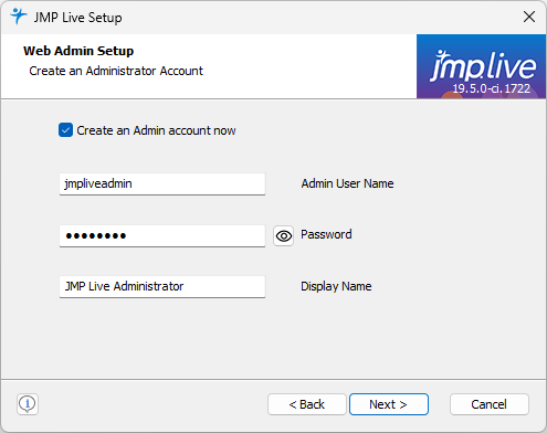

Figure 1.24 Create an Administrator Account
Note: It is strongly recommended that you create an administrator account. However, if you are updating JMP Live from a previous version and already have an administrator account in the database, then you can safely skip this step by deselecting the Create an Admin account now box.
13.
Enter the administrator user name that you will log on to JMP Live with. Provide a password (default is password) and a display name that will appear when you post content to JMP Live. Note the following:
The Admin User Name must not contain spaces and must be lowercase.
Once you create an administrator account, you can log on to this account and designate other users as administrators.

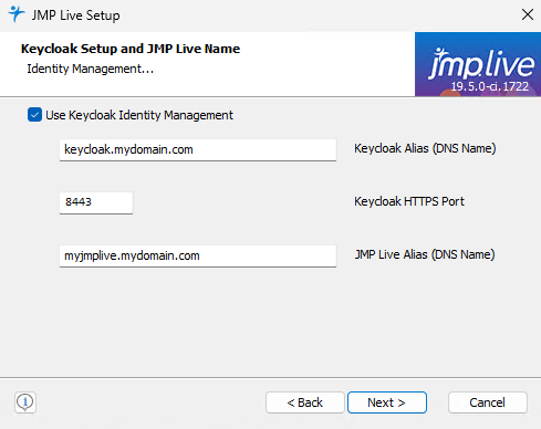

Figure 1.26 Set Up Keycloak
Set Up Keycloak
16.
Specify the following Keycloak settings:
Use Keycloak Identity Management: Enables the Keycloak authentication system. If you deselect this option, Local authentication is used. In this case, users need to create accounts in JMP Live. These users are not authenticated against different identity providers. For details about connecting Keycloak to your identity provider, see the Keycloak documentation.
Keycloak Alias (DNS Name): Specify the name of the server machine that is running the Keycloak authentication service.
Keycloak HTTPS Port: Specify the number of the port that Keycloak expects to receive requests on. The default port is 8443.
JMP Live Alias (DNS Name): Specify the name of the machine that will run the main JMP Live site.

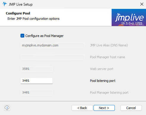

17.
If you want to run the Pool Manager on this machine, select the Configure as Pool Manager box:
If you are using one machine for all components, or one machine for the Pool Manager and JMP sessions, select this option.
If you are using this machine for a worker pool only, do not select this option.
18.
Specify the Pool Manager options:
JMP Live Alias (DNS Name): Enter the DNS name, which typically looks like this: machine name.domain name.com. Note the following:
Unless you are installing all components using the localhost option, you need to specify the web host name.
Even if you have all components on one machine, you likely want to use your organization's SSL certificates for a secure connection. In that case, specify the machine name as the web host name, since the certificates are usually tied to the machine.
Pool Manager host name: (Disabled if you are selected Configure as Pool Manager.) If you are setting up a worker pool on a separate machine, enter the DNS name of the machine that is handling the Pool Manager duties.
Web server port: (Disabled if you are installing all components on the same machine, as the port number is already specified in the JMP web component.) If you are installing only the JMP Pool component, enter the port that you used when installing the JMP web component on another machine.
Pool listening port: Enter the port that this pool is listening on for communication from the JMP Pool Manager and JMP web components.
Pool Manager listening port: (Enabled only if you are configuring a worker pool.) Enter the port that was specified as the Pool listening port for the JMP Pool Manager setup. The worker pool needs to know this port in order to tell the JMP Pool Manager that it is available.

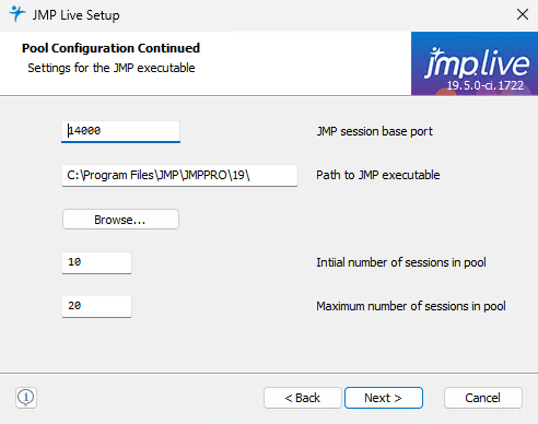

Figure 1.28 Configure JMP Settings
JMP needs to be installed using its own installer on all machines that support creating JMP sessions, whether that is part of the JMP Pool Manager or the worker pool. These sessions of JMP will be started to do work for JMP Live when reports are modified.
19.
Specify these JMP details:
JMP session base port: Enter the base port used by the JMP sessions to talk with the JMP Pool Manager. Each instance of JMP has a unique number starting with this base number.
Path to JMP executable: Enter the path to the JMP Pro location. The default installation path appears, so you need to change this only if JMP Pro is located elsewhere.
Initial number of sessions in pool: Enter the number of JMP sessions that will be started when the pool is first run.
Maximum number of sessions in pool: Enter the upper limit for the number of JMP sessions that are allowed to run on this machine as part of this pool. These sessions are added if the number specified in the initial number of sessions are all in use.
Note: If you are installing the Pool Manager, and only want it to handle resource allocation to other worker pools, you can set both the initial and the maximum numbers to zero. In this case, the site will not function until worker pools are configured and running.

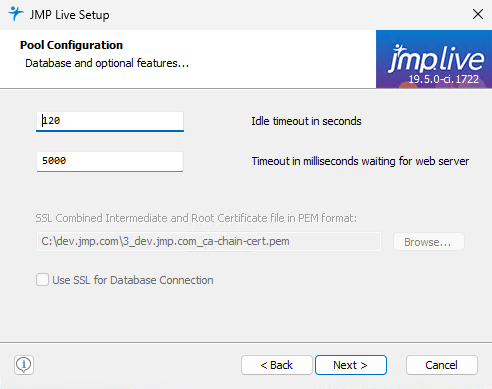

Idle timeout in seconds: Enter the length of time that a JMP instance waits for additional work before dropping the connection with the JMP web component and waiting for a new request.
Timeout in milliseconds waiting for web server: Enter how long an instance waits for further communication during an existing transaction before it gives up and discards the existing work request.
SSL Combined Intermediate and Root Certificate file in PEM format: (Appears if you are installing the JMP Pool Manager component only) Specify the location of the certificate file that combines the Intermediate and Root certificates (in that order).
