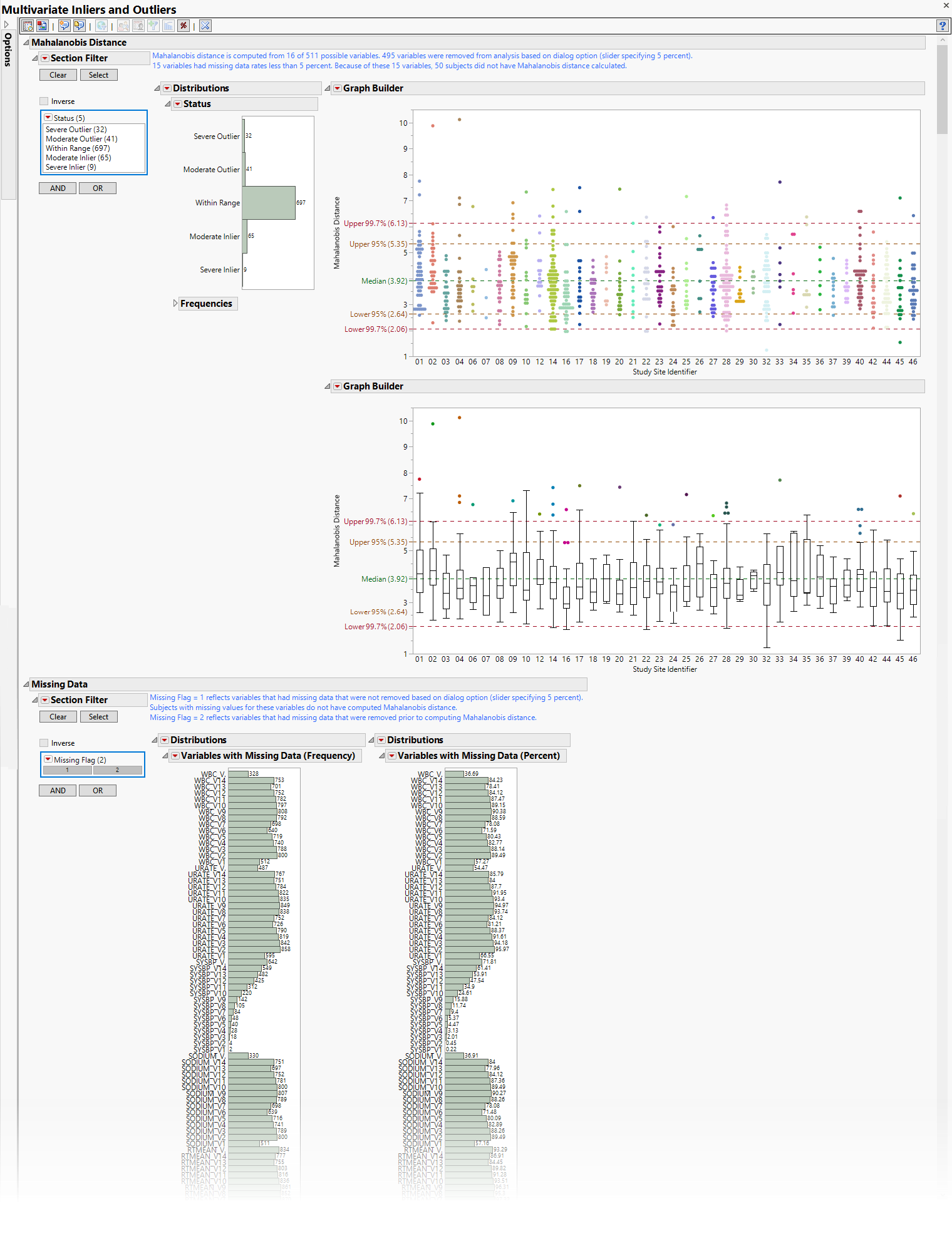

The report initially shows two sections.

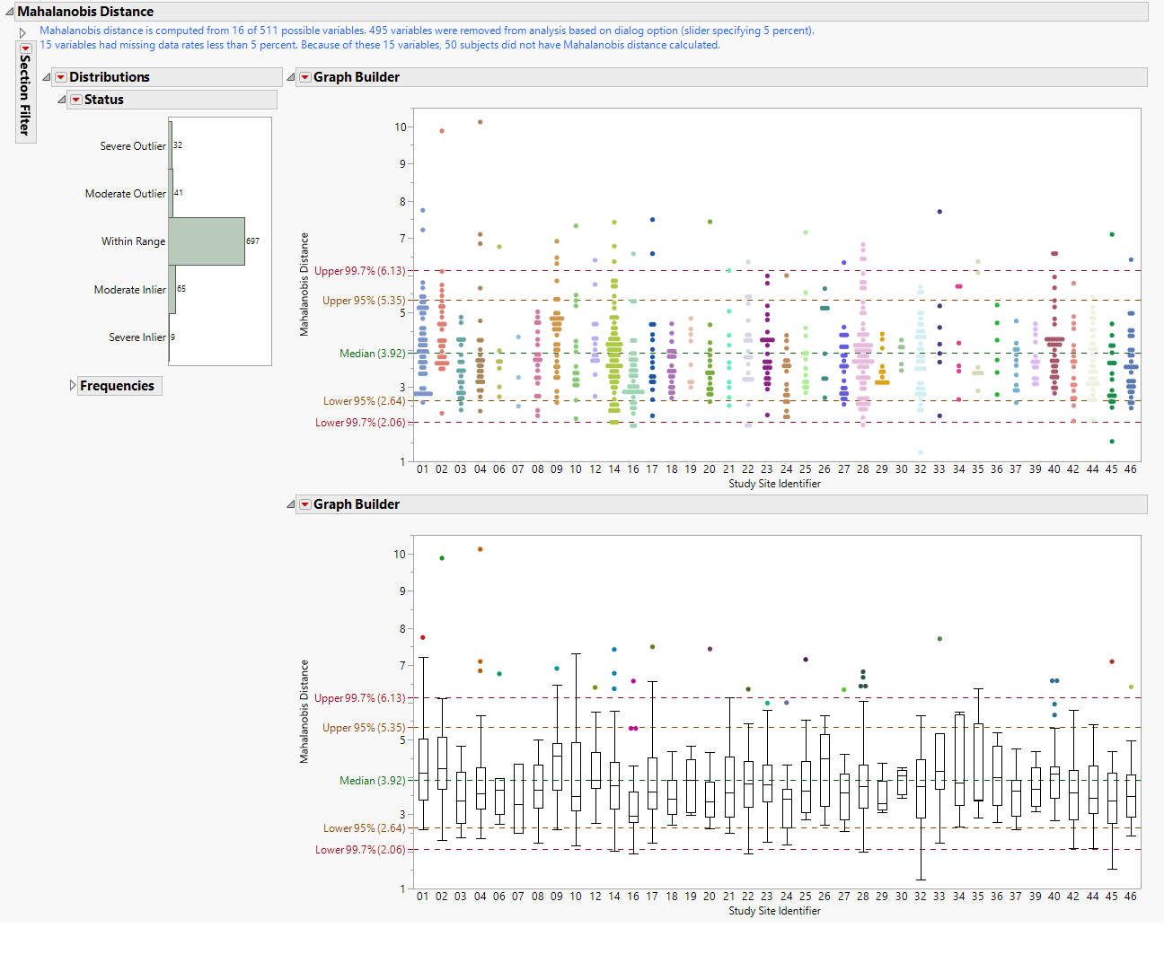

Mahalanobis Distance
Presents plots of Mahalanobis Distances of all subjects (distance is from the multivariate mean), colored by study site, and Box Plots presented by sites.
This section contains the following elements:
| • | One JMP Mahalanobis Distances plot to identify significant outliers. In the Mahalanobis Distances plot shown above, the distance of each specific observation from the mean center of the other observations from the site is plotted. Those points residing above the upper 95% confidence interval (outliers) or below the lower 95% confidence interval (inliers) correspond to those rows that warrant the most attention due to their significant distance from the mean center of all other observations. The region between 95% and 99.7% is referred to as a moderate inlier or outlier depending of it is in the lower or upper bounds, respectively. Beyond 99.7 is considered a severe outlier or inlier. |
| • | One Box Plot. |
The second figure replaces points seen in the Mahalonobis plot with box plots by study site. This allows the analyst to better determine how different sites are from the multivariate mean.

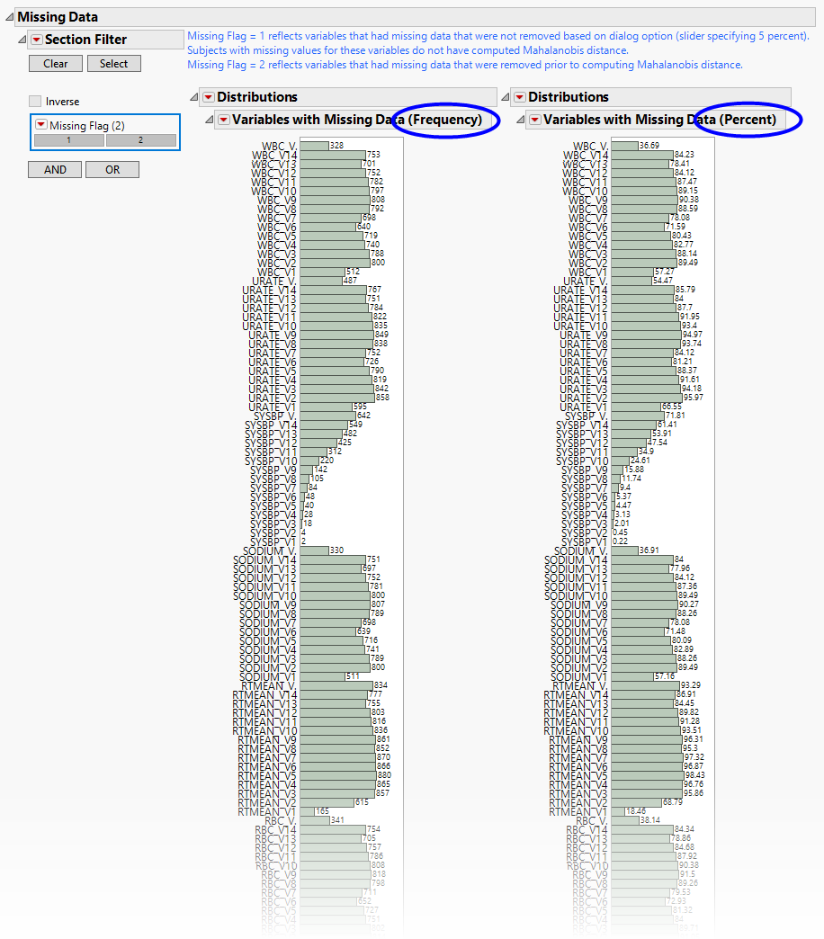

Missing Data
This section has the following elements:
| • | Two Histograms. |
Details variables that contain missing data that prevented Mahalonobis distances from being calculated for certain subjects (Flag = 1) or variables that were dropped from analysis based on the option Remove variables from analysis with a missing data percentage of at least:. By default, variables with 5% or more of missing data are not used in the calculation of Mahalanobis Distance. Data are presented either as counts (left) or percentages (right) reflect the number of values that are missing for each variable. Opening the data table shows the percentage of missing data for each test.

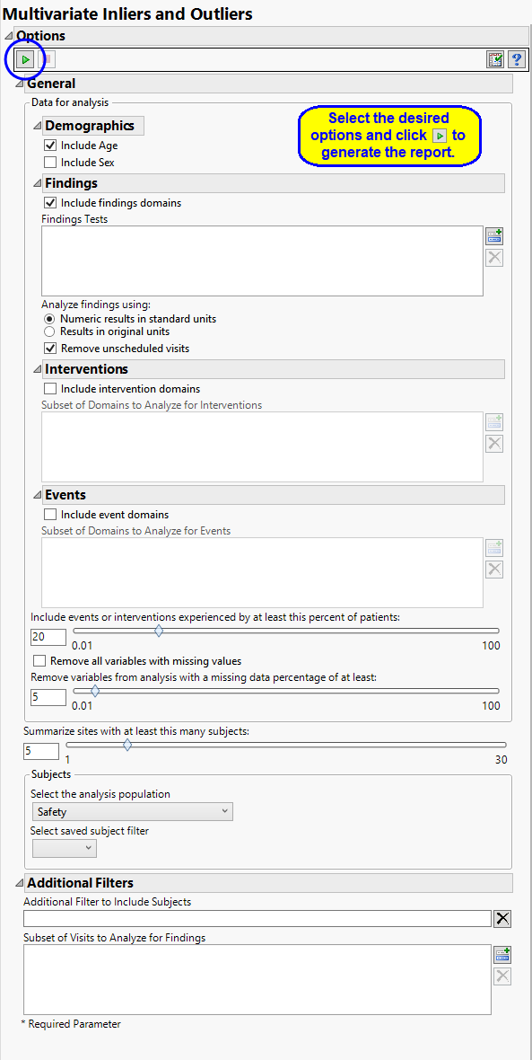

Report Options
Demographics
The Include Age and Include Sex are used to include age and sex (when these are not matching criteria) in the analysis for computing distance.
Findings
You can opt to Include findings domains to analyze and summarize findings by visit and time point number. If you decide to include finding results, you must specify which Findings Tests to include and whether to Analyze findings using: using original or standard units. Check the Remove unscheduled visits option to included findings from scheduled visits only; leave the option unchecked to include findings from all visits.
Interventions
You can opt to Include intervention domains to analyze the frequency of each intervention. By default, all intervention domains are included. However, you can restrict the analysis to domains specified using the Subset of Domains to Analyze for Interventions option.
Events
You can opt to Include event domains to analyze the frequency of each event. By default, all event domains are included. However, you can restrict the analysis to domains specified using the Subset of Domains to Analyze for Events option. You can use the following options to exclude events:
The Include events or interventions experienced by at least this percent of patients: option includes all events that are experienced by the specified threshold percentage of subjects; events not meeting this threshold are excluded.
Checking the Remove all variables with missing values option excludes all variables with one or more missing values. The Remove variables from analysis with a missing data percentage of at least: option enables you to be more permissive with regards to missing data. When the Remove all variables with missing values option is not checked, you can specify a threshold value for exclusion; only those variables whose percentage of missing values exceeds this threshold are excluded. All other variables are included in the analysis.
Site Summary
Use the Summarize sites with at least this many subjects: option to specify the number of subjects a site must have in the selected population in order to include it in the summary.
